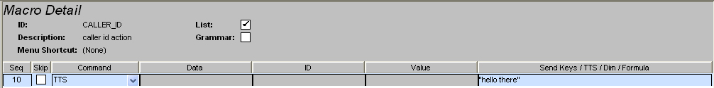

Alright, I am still requiring some help here. Out of the blue today I had the PH system speak to me. They were both "unknown callers", the log shows the events taking place. Since then, it doesn't trigger. So I have takin some screen shots to post so hopefully one of you can tell me what I am missing at this point. Right now, all I am trying to do is get PH to say "hello there" so I know it is at least working. I do know that PH is talking to the modem, I added a "h1" command at then end of the init string, and when I re-initialized PH, the modem did go off hook, so the port etc. is set correctly.
First the Plugin Screen:
Now the simple macro I am using for testing:
and finally the trigger:
When it did trigger for whatever reason, these are the log entries:
I just don't know where else to go with this.... somebody??.. anybody??
