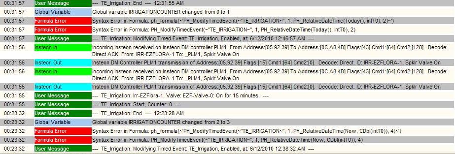

Posted: June 12 2010 at 01:14 | IP Logged
I am trying to get my irrigation routine going, and am running into problems (again) with RelativeDateTime.
If I hardcode the routine as seen on the command line "OK", I get no errors.
For almost every other combination, with two left as NG to show, I get syntax errors in the event log (see below).
Looks like I am running into problems with variables...
Any thoughts?
Thank you.

Posted: June 12 2010 at 12:39 | IP Logged
The two variants that do not work are trying to use Script variables (intTO, dtNextTime) within the quoted string passed to PH. VB Script is not going to do substitution because the reference is within a quoted string so it looks like and is being treated as data by the Script processor. Once PowerHome starts processing the quoted string the VB Script variables cannot be resolved by PowerHome.
EDIT: if you wanted to display a message ....
The value of intTO is : intTO
you would want the first intTO to be treated as data and the second intTO as a variable. To accomplish you would code...
"The Value of intTO is : " intTO
so that the intTO inside the quoted string would be treated as data and the one outside the quoted string would be treated as a variable.
Edited by grif091 - June 12 2010 at 13:26

Posted: June 14 2010 at 09:36 | IP Logged
Yep - that makes sense. Didn't see that coming.
So I should be OK if the command would read like this:
rv = PH.Formula("PH_ModifyTimedEvent(""TE_IRRIGATION"", 1, PH_RelativeDateTime(Today(), " & CDbl(intT0) & "), 4)")
I will test tonight from home.
If that doesn't work, then I will rework the logic, since I remember that there is no PH.ModifyTimedEvent, is the PH.CreateTimedEvent OK?
Thank you.
Posted: June 14 2010 at 10:58 | IP Logged
I don't know if VB Script will like that syntax but you have the idea correct. If that does not work try putting the string together with VB construct first and then pass the result to PH.
stringPH = "xxx xxx xxx" & intTO & "yyy yyy yyy"
rv = ph.formula(stringPH)
Don't know if that syntax will work either but it is another approach. Either way the VB Script variable that you want substituted cannot be within a quoted string.
Edited by grif091 - June 14 2010 at 10:59

Posted: June 14 2010 at 11:10 | IP Logged
Exactly. In theory it should work fine. I'll give it a try tonight and post the results.
Thank you!
RichardL Senior Member
Joined: December 29 2008 Location: United States
Online Status: Offline Posts: 165
Posted: July 01 2010 at 10:41 | IP Logged
Yep the embedding of the variable works. I got around to testing.
