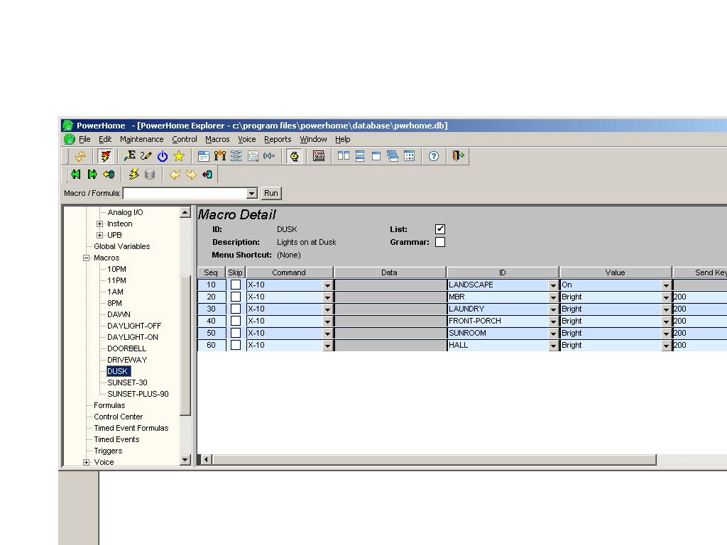

thanks Dave. Not sure what the best way to post a macro is - here's a screen shot of the config in the Explorer:
the macro is set up to be triggered via a timed event. When dusk rolled around and the lights didn't go on, I started investigating. In the event log example above it was run manually, shortly after re-initializing PH.

Question.. Why one “ON” and all the others BRIGHT to different modules? I normally send an ON then a BRIGHT to the same module.

BeachBum wrote:
| Question.. Why one “ON” and all the others BRIGHT to different modules? I normally send an ON then a BRIGHT to the same module. |
I was wondering that exact same thing myself Pete, but it has been so long since I used X10 exclusively I could not begin to say.
| Posted: November 25 2008 at 15:02 | IP Logged
Here I go again thinking out loud but I wonder if PH is getting hosed with X10 commands and no module address first?
| Posted: November 25 2008 at 16:26 | IP Logged
Well, that screenshot was immensly helpful as I traced the code and found the problem.
I'll give you the quick fix first...change the Bright 200 to Bright 100 (don't ever go over 100).
The long reason...not sure if this affects other X10 controllers or not, but it definately affects the CM11A. The CM11A is different from most X10 controllers as the commands to tell it to dim or bright is based upon a percentage from 0 to 100 inclusive. You can't tell the CM11A to dim less than 0 or more than 100. Other controllers are told to dim/bright and they will dim/bright a single step, usually about 3.8%. To dim/bright more than that amount requires the command to be repeated multiple times. But the CM11A is different and can be told to dim anywhere from 0 to 100 in a single command. Based upon the CM11A protocol, this number needs to be equated to a value from 0 to 21 steps. There is basically some more math to match the protocol, etc. but ultimately what was happening in your case was that the bright value of 200 was being converted into an equivalent CM11A character value of 350 (character values can only range from 0 to 255). This value was being looked up in an array with only 255 members which is obviously beyond out of range and generating a run-time subscript out of range error. This was ultimately caught by the try/catch routines for the execution queue resulting in the error message. The exe queue was reset and recovered from the error, but the CM11A is basically hung because it's in the middle of processing with no way to get back. You *may* have been able to recover without reiniting by doing a Controller Disconnect followed by a Controller Connect (this *should* reset the CM11A module) but the real fix is to not try to dim/bright beyond 0 thru 100 with a CM11A. If you want 200%, then just run the 100% command a second time.
I'll put some form of error checking into the code to catch this situation as well.

* I use On and Off commands exclusively for my landscape lights, which are not dimmable. All other devices in that macro are dimmable, so I use Bright with a level. Never tried using both On and Bright though.
* I was using a Bright value of 200 because a value of 100 never seemed to bring the device to anywhere near full brightness. And I thought I had tested that out on a single device before changing them all, and I was sure that it had worked without a problem, but after seeing Dave's explanation I don't imagine it ever could have worked.
