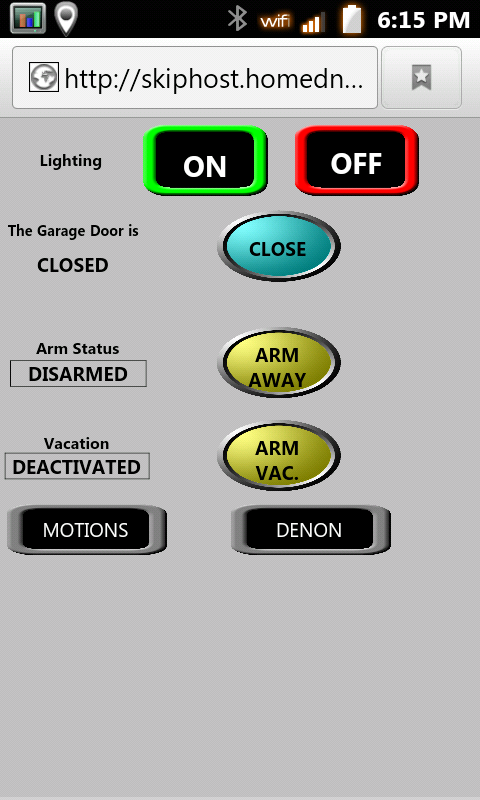

I used the control center to create a page for controlling my garage door. I purposely coded it so it cannot open the door--
only close it (personal preference). You need to realize of course that if someone were to get a hold of our phone and it
had the capability to open your door, they they would obviously be able to do so. That being said, it didn't take long at
all for me to code it all up.
