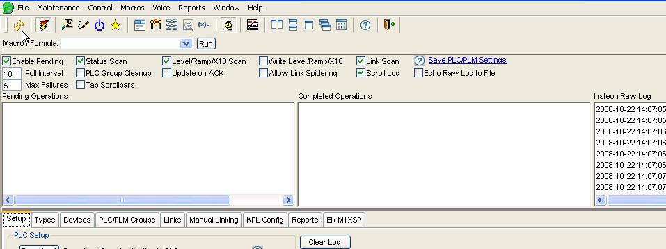

I've been playing around and can't seem to figure out how to get a trigger to fire. I'm sure once I see the mechanics I'll be good, but as a test I'm just trying to fire a macro when a light switch is turned on. I'm in an Insteon environment (mostly). The screen shot is what I came up with but it doesn't do the trick.
I've tried several ways of doing this, I've changed the Trigger Type to be every different kind of Insteon but no luck. In this screen shot I've said (I think) that if ANY Insteon device does ANYTHING then run the macro. Maybe not?
Process flow:
HALL LIGHT SWITCH IS TURNED ON -> Run the macro, which is a 15 second timer to turn it back off again
Pretty simple.
Thanks!

I'm wondering something... I notice that my Insteon screen doesn't seem to be polling anymore - which would certainly mean triggers won't happen. Is there someplace that I might have turned that off?

Upper left corner of Insteon Explorer, Enable Pending and Status Scan need to be checked for PH to check devices on the Poll Interval time increment.

Both of those are checked, but still no polling. Interestingly, my PH web server stopped working as well, I wonder if they are connected (and yes, there is no firewall running).

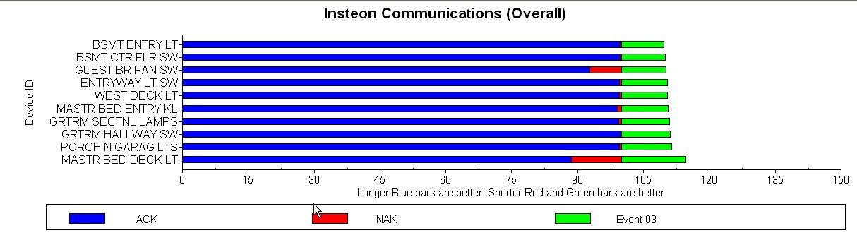

No red COMMS in Insteon Explorer right?

Only what I would consider as somewhat normal, see screenshot. Everything is working well, actually, just that polling doesn't happen and thus triggers don't fire :(.

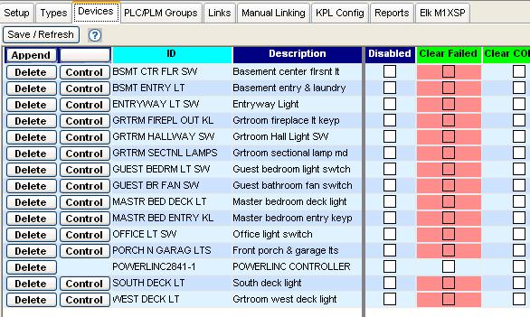

I was referring to the Device Tab. You might also check this post.
I'm taking it then that this is NOT a good thing ? I didn't know what that was supposed to mean when they were red, but I assumed that it hadn't polled it and that's why it was red....
Posted: October 22 2008 at 18:44 | IP Logged
Put a check mark in the Clear Failed column for every device that is shaded. Communication over the powerline was lost at some point for that many devices to be marked as failed. If it comes back, try pulling the plug on your PLM/PLC for a few seconds and then try again.

grif091 wrote:
Put a check mark in the Clear Failed column for every device that is shaded. |
You ROCK! That fixed it
Thank you, I thought I tried that, but I had done the 'clear comms' instead.
