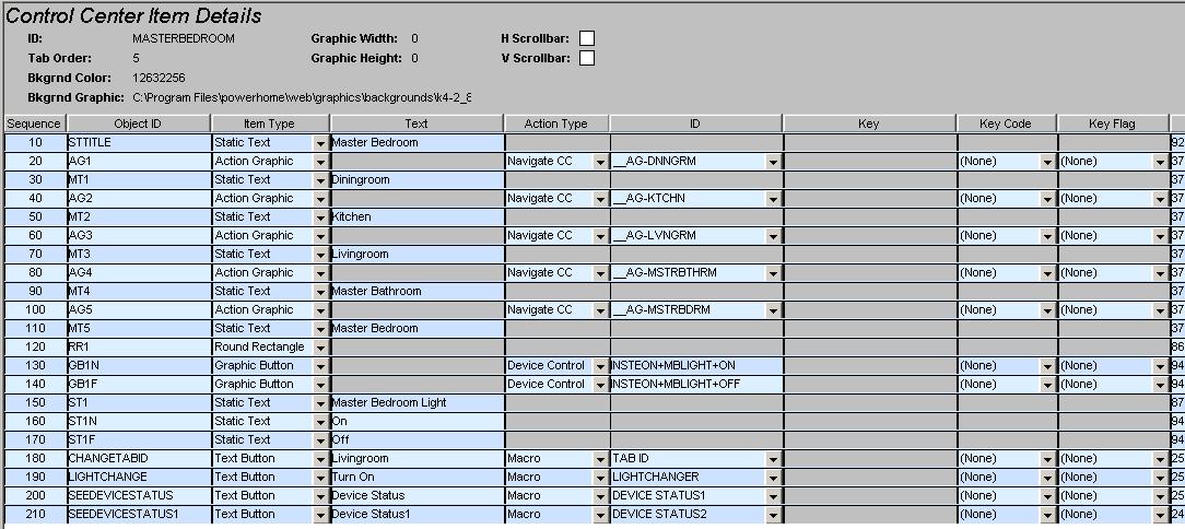

Would someone point out the syntax error for this formula?
ph_setccobjgraphic ( "MASTERBEDROOM", "GB1N", C:\Program Files\powerhome\web\graphics\buttons\b1red-d_50.gif, ,0) |
Event log:
Syntax Error in Formula: ph_setccobjgraphic ( ~"MASTERBEDROOM~", ~"GB1N~", C:\Program Files\powerhome\web\graphics\buttons\b1red-d_50.gif, ,0) |
Here is a copy of the control center via the explorer page.
As you can see the tab id and button id are correct. I'm not sure what to put in the downfile and flag?

Unless the forum trashed it, I'd say the missing quotes around the paths...
ph_setccobjgraphic ( "MASTERBEDROOM", "GB1N", "C:\Program Files\powerhome\web\graphics\buttons\b1red-d_50.gif","",0)
downfile is a path to the graphic for the pressed state. I'm not sure if it would be better to just duplicate the first path or leave it null.

This seems to work OK.
ph_setccobjgraphic ( "MASTERBEDROOM", "GB1N", "C:\Program Files\powerhome\web\graphics\buttons\b1green-d_50.gif","") |
