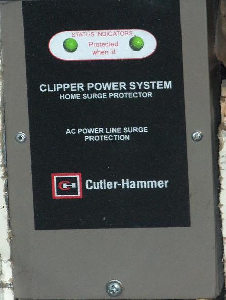

| Posted: February 06 2011 at 23:22 | IP Logged
Could it be the surges that are causing the problem? We also have underground utilities but I installed a whole house surge protector and have not had any issues with KPL.

| Posted: February 08 2011 at 12:24 | IP Logged
Good point, but yes I too have a whole house surge protector. See photo. Do you know if they "go bad". I have had it for probably about 8 years now. ...or any other KPL thoughts?
I have APC power supplies for all my computers, with their software running. However, they state that events of short durations are not recorded into the logs.

| Posted: February 08 2011 at 13:50 | IP Logged
I have a whole house surge protector mounted on the power meter by the electric company. Mine went bad during a hurricane. I called the electric company and informed them the surge protector did not protect be from the surge. It took them a little while to see the humor in it as the surge was a 12 foot wall of water.
My battery backup for the computer has a program which monitors the power and logs any noise, outage or surge. Lee is the expert on KPLs and if he doesn’t have a solution you might be stuck with the problem.
