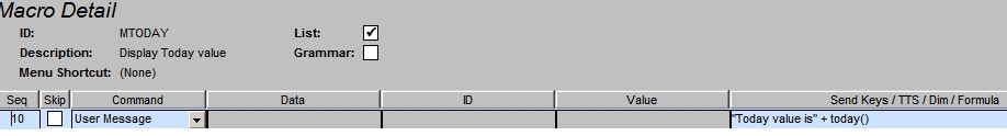

I'm taking your advice and I have a question.
How would I go about displaying the result of the today() function. Also what would be the best place to create a macro/function so that it can be executed?
Posted: January 18 2009 at 18:41 | IP Logged
Use PowerHome Explorer, click on Macros, right click in large white space on the right, select Insert, enter the macro ID MTODAY (arbitrary ID) and free form description, click on small box to left of macro ID, enter the macro information in the following screen capture and press PF5 to save macro. Enter the macro ID in the Macro/Formula field in the upper left section of the main Powerhome window and click on Run. The user message is displayed in the event log, the last line of which is displayed at the bottom of the main Powerhome window.
