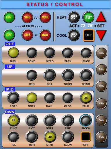

A week ago I undertook a major effort to create a CC
center that would allow me to control lights and furnace
from my iPhone while we were traveling, as well as
enable/disable SMS and email messages to my phone when
the security cameras detected motion.
As of a few moments ago it all works! Of course it will continue to improve over the weeks ahead, but at least I've got pretty decent functionality for the moment.
I want to add sliders for the dimmable lights. Right
now I've just got them controllable to On/Off states.
The furnace, however, is nicely controlled to specific
or variable settings.
The 3 Heat/Cool buttons set specific (normal) settings,
but can be modified with the up/down arrows on the right
by 1 degree per tap. To save window space, instead of
posting text to indicate furnace mode, I changed the
colors of the up/dwn arrows with gray being off, red
being Heat, and blue for Cool.
The 4 buttons on the upper left set/clear enablingflags
that send SMS messages to my cell phone, or emailwith an
attached image from the camera that detected motion.
This allows me to have as much or little alerting as I
need.

I was thinking (in the middle of the night which is when
I get the best brain farts) that instead of lighting
sliders, I can do the same thing that I did for the
furnace (to keep things really visually simple).
Adding a single up/dwn incremental control (say 10%
increments) I could tap a light to turn it on/off and
then tap the incremental control to change the light
setting. By logging out the last CC button tap to a
Global Var I can remember the last button tapped, and
use that device name in the Insteon control. If a light
is not full on or off then I can post an intensity
(Static Global Var) level over the light control button
so the lighting value is visible.
While this is not as perfect as a full slider panel, it
offers a lot of control in a compact configuration.

Looks great. I haven't forayed into video yet. What
kind of cameras are you using and how do you like them?
As to sliders for lights, I put in a lot of effort a
while ago to implement this. While it works well from
a PC and a large screen, it's less useful on the iTouch
and Treo because it requires many overlapping small
boxes which don't translate well on a small screen.
However, since that time Dave has added the various
global variable types to the Control Center. If I did
it again I would add a global variable for each light
and update it with a ph_getinsteonlevelrt function.
This gives the light level from 1 to 255 which you then
can manipulate mathematically.
