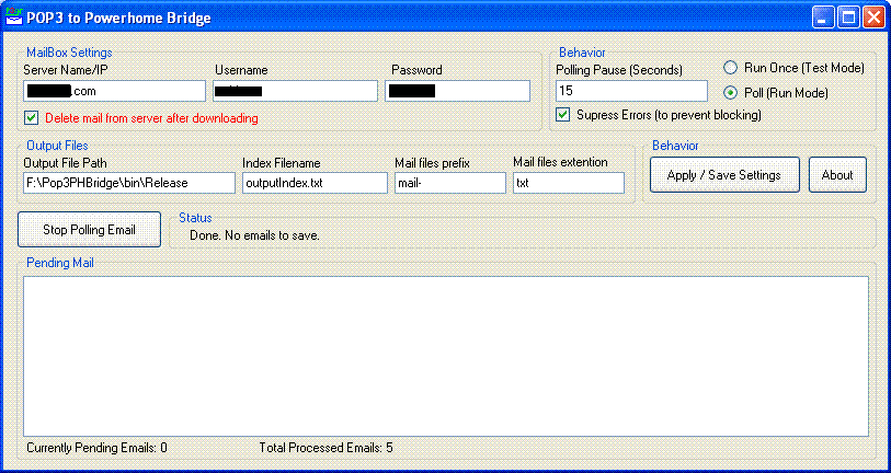

While waiting for a propper POP3 plugin I hacked this together (see this article for history. Basically it's a vb app that goes to a specified pop3 mailbox, downloads all the emails it finds, writes a timestamped file containing the found emails, then appends the newly created file name to an index file.
By using Dave's file monitor plug in to monitor the index file (see this article) it should be easy to write a PH macro to read a line from the index file open the specified email file and process each email in the file.
Emails are saved in the format:
FROM_ADDRESS<ta b>S UBJECT <tab>BODY
All on one line. Before saving the email body is stripped of all white space (CR/LF/tabs/multiple spaces). If the email is a multi-part email the app tries to save only the plain text part.
I'm going to use this to handle remote control via email and sms. It could also be useful if you wanted PH to display a pending email list somewhere.
Screen shot:
Notes:
1. If you are using this for control I'd strongly recommend using a dedicated email account since you'll want to check the "delete mail from server..." checkbox as this app has no concept of a "new" mail - it always just saves everything it can find.
2. There is no security here. The senders email is just pulled from the "FROM:" entry in the mail header - it would be supper easy to fake. I'm going to use this, but that's my informed choice.
3. This does not support "SSL" so it may not work with your server. For example, it will NOT work with gmail.
4. No guarentees this is of any use to you. It works well for me but has not been tested on more than a handful of server or with more than a few email sources. It's probably just worth just what you paid for it.
Let me know if you have any questions / comments!
Thanks, Tony

Some examples. After running for a bit with the above settings the app had created three files:
The contents of "outputIndex.txt":
C:\Program Files\PowerHome\mail\mail-128419812085016440.txt
C:\Program Files\PowerHome\mail\mail-128419816477560238.txt
The contents of "mail-128419812085016440.txt":
XXX@tmomail.net set heat on
The only email that was contained was sent from my phone, so no subject. Guess what it does?

So the outputIndex is just a list of files that need to be processed (this is the file to watch with the file monitor plugin). So it looks correct.
The mail-xxx file is not stripping out the mime information. One easy fix is to send the email as "text only" / unformatted text / whatever it's called on your client. Otherwise it should be easy enough for you to proccess the email in PH.
The way I deal with this is just use string matching - I don't try to actually parse the email. The first think my proccess macro does is convert the entire mail-xxx file to upper case ("upper()") then look for the substring for each command I expect ("HEAT ON", "HEAT OFF" "PORCH ON", "WALK OFF", etc) the beauty of this method is it does not matter that there is a lot of noise in the email (it would handle your above files just fine). The disadvantage is that there is no context, so if you sent the email "HEAT ON... PORCH ON... HEAT OFF" you might expect the heat to go on, the porch light to go on, and then the heat to go off. Instead the commands will happen in whatever order you checked for them.
After I process an email I return a status email which includes the status of all setable devices - this doubles as a "help" screen since everything is listed in the format that is expected.
So my macro does the following:
1. Reads the Index file, then deletes it.
2. Parses the index file and for each email file reads the file and deletes it.
3. Makes the file content all uppercase, and checks the received email addresses against a list of accepted emails (minimum security). If the email doesn't match then just exit.
4. Checks for any "command strings", and executes the appropriate command for any found.
5. Sends a status email back to the sender
Note that if you send a blank email, or gibberish you still get a status email back - by design.
